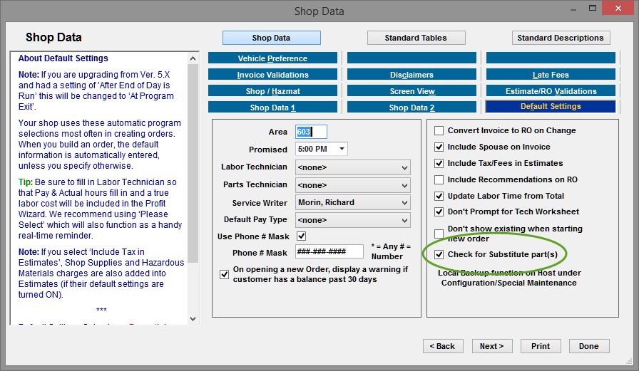

It sounds to me like the first location has the Setup - Shop Data - Default Settings > Check for Substitute Parts box checked (below) and your second location doesn't.
In the first instance (box checked), it sees that you have the part in your inventory; when you select to use that inventory part, it uses the pricing of the inventory record (matrix or User Entered Sale Price in this case).
In the second instance (box unchecked), it doesn't reference your inventory and just uses the catalog part (fed to Markup Matrix) instead.
Re: Transferred Items Not Removing From Inventory?
If you want to grab parts from inventory that may have a different line code, you're going to want to select this box.
Substitute Parts
Substitute Parts

the line code was the problem, but that box was also not checked.
I think ill go back and update all line codes and check that box.
thank you for the quick replies.. this has been plaguing me for 3 months and finally taking the time to get to the bottom of it.
If that box had been checked, it wouldn't have mattered if the line codes were the same. Glad you got it figured out.
