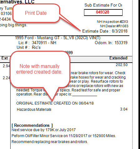

Estimates printed from Revisions show the print date, not the created date. You can add a note to manually show the created date as I have below. I don;t know why yours didn't print, but it does. I used Est w/o hours in this example.
Add a note to provide a created date on an Estimate

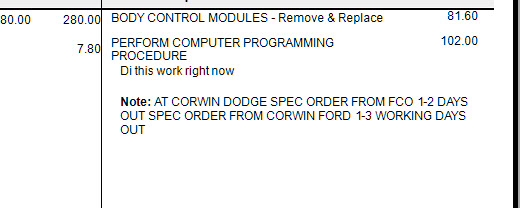

I wonder if you are 'seeing the note", I see it may be hard to discern which text IS the note. There is no line break after 'work performed'. Perhaps it needs a bit of special treatment to
make the note more visible?
Re: Reprinting Estimates
I had the same problem at first. I added a period to the first line to force the rest of the text down a line. :D
