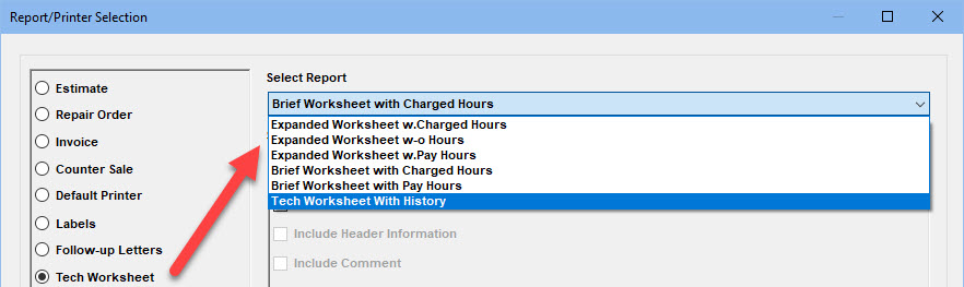

The tech work sheets should be customizable. They don't quite work for the way our company is structured. Is there a way to see the tech sheets individually?
Posts: 4538
Re: Tech Worksheet
Understood - would be good to hear your specifics to see what other shops think.
If you go to Configuration - Reports/Printers and select Tech Worksheet you may select each and try them out with a screen preview.
We also have SE Reports Pack (2013) with samples of all reports and templates with actual shop data to see how they look. (not include is the new TW with history option but that's in Reports/Printers - TW list).

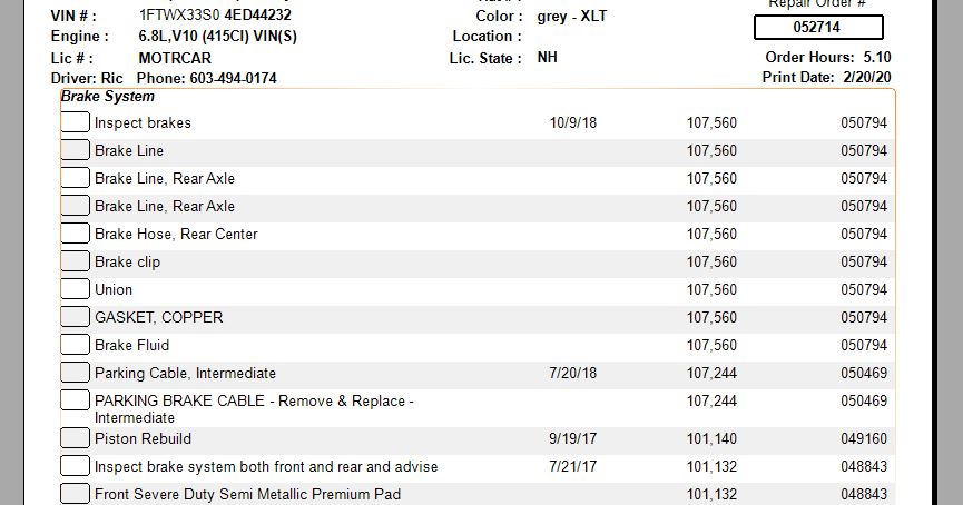

I would love it (or rather, my techs would love it) if the tech worksheet with history would include mileage with each history item :)

It does include mileage, at least mine does.

Mine only has mileage in (and in the past, we only entered mileage out...guess that is our mistake :( )
