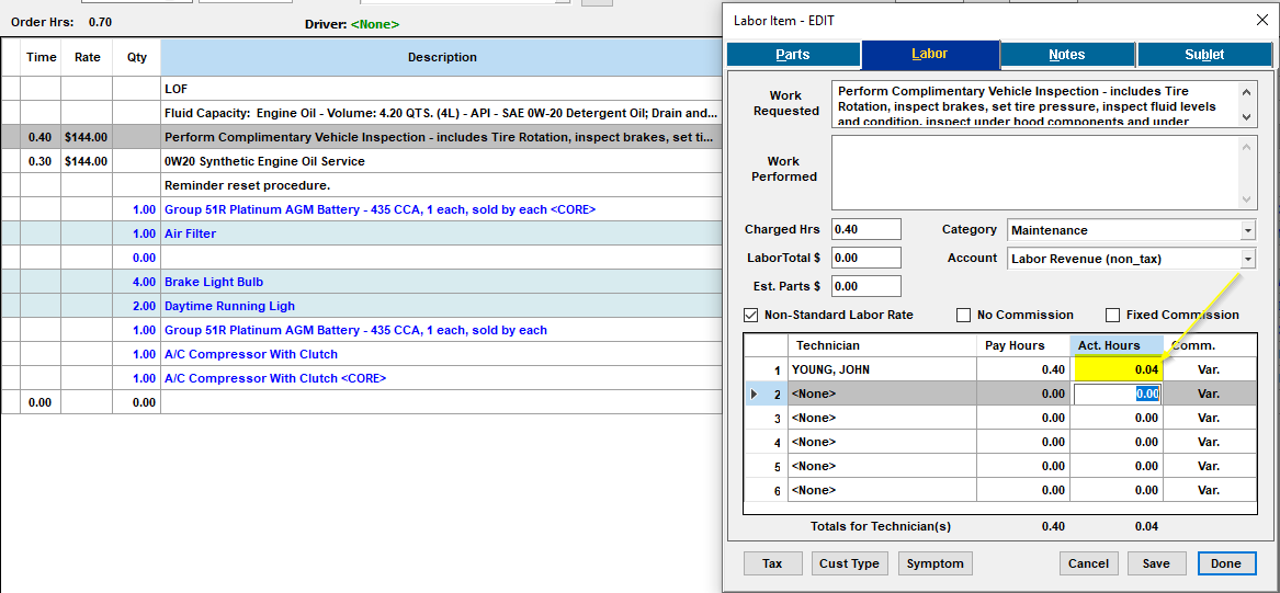

It does update the Actual Hours on the line item in the RO once completed. There is no special setting for that. You mention the time on the RO in the WIP - there is no such thing. This leads me to wonder if you're referring to the Charged Hours? That is not something the Time Clock will ever modify.
The value changed by the time clock entry so we're on the same page:
You can see I didn't allow the clock to run very long in this case. :)

SO what you are saying then is that I need to take the actual hours and put it up in the charged hours? It appears that this step is what I am missing. I had somehow naively assumed that the time clock would automatically place the actual hours in the charged hours. If that is the case, then moving forward I need to pay attention.
Thanks for the explanation!

Understood. Glad it's clarified now. For the record - we'd never change the charged time based on technician time. First, it's not legal to deviate from the estimate in several states in the event a technician takes longer than expected. Second, it's not a good business practice to reduce the charged time just because you might have a rockstar technician completing everything ahead of book time.
