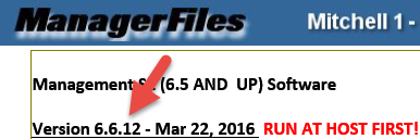

I am still on 6.6.10. Should this have been automatic or do I need to download to 6.6.12? Thanks.
Re: Update to 7.0.7?
Jeff @ Able Auto wrote:I am still on 6.6.10. Should this have been automatic or do I need to download to 6.6.12? Thanks.
Should have been; if not download from here: http://www.m1faqs.com/fix/SE/index.htm
