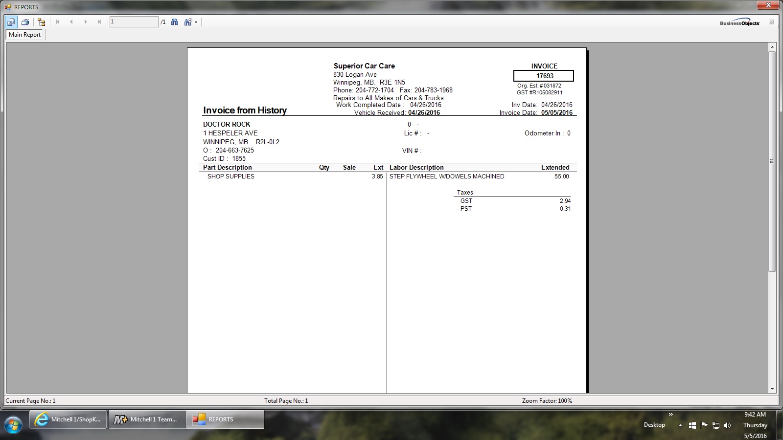

Here Are Screen Capture Of Invoice Showing Tax, And Image Of Tax Window. Let Me Know If That Is What You Need. Thanks
Posts: 1114
Re: Tax On Shop Supplies?
To get the $2.94 in GST only, go into the Order Options > Tax Rates applied and uncheck the PST.

I noticed the tax screen you captured from an individual LABOR line, not a part line. To turn the tax off for the order, go to options, select "Tax Rates Applied' and set the order as non taxable.

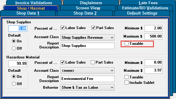

Is this box checked? Global decision; are you never supposed to charge tax on Shop Supplies?

My mistake, I thought you wanted the GST to still apply on Shop Supplies as well. In order to have them not be taxed, go into the Order Options, uncheck the apply box for both taxes. Answer Yes to updating the lines on the order. Then edit the labor line and apply the GST again. The total tax in your example should just be the $2.75 of GST on the labor.
This is all based on if you'd rather leave the taxable box of the Shop/Hazmat setup checked always.
